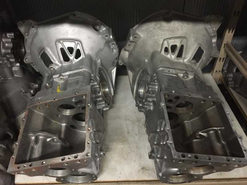

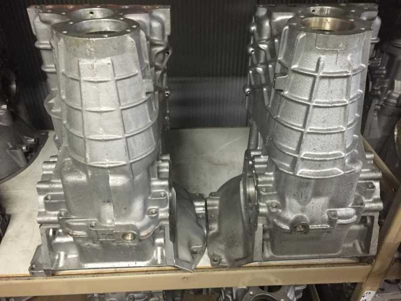

Also das ist m.E: die erste Dämlichkeit von Cit, sowas doppelt zu bauen. Das ist beim PRV intelligenter gemacht.
Aber an irgend was mussten die Cits ja pleite gehen.
Re: Getriebe
01 Sep. 2017 13:45 - 01 Sep. 2017 13:46
#128
Links ist das Merak Getriebe, die Deckel sind offenbar baugleich, also nicht gespiegelt, siehe Löcher vorn und hinten..
Letzte Änderung: 01 Sep. 2017 13:46 von citroenist.

hier ein Beitrag von Harry Martens aus einem anderen Forum:
Hi
Lotus Esprit Giugiaro gearbox is the same as SM till 1983. It was know as "previous" Citroen. From 1983 to 1988 they used the so called " C 35 "casing. Some internals were also changed.
Bellhousing was specific for Lotus. Turbo and non Turbo.
The Maserati Merak has the same engine as the Citroen SM but in the rear and therefore they needed to convert the rotation of the gearbox. It was completely mirrored. Gearbox casing, bell housing, 5th gear carter and cover. Also internals were mirrored.
Lotus had the luck, their engine rotates in the correct way, opposite to the Maserati engine,so the SM gearbox was a plug and play unit.
See photo, left casing is Merak.
Cheers,
Harry Martens
Bilder dazu:
